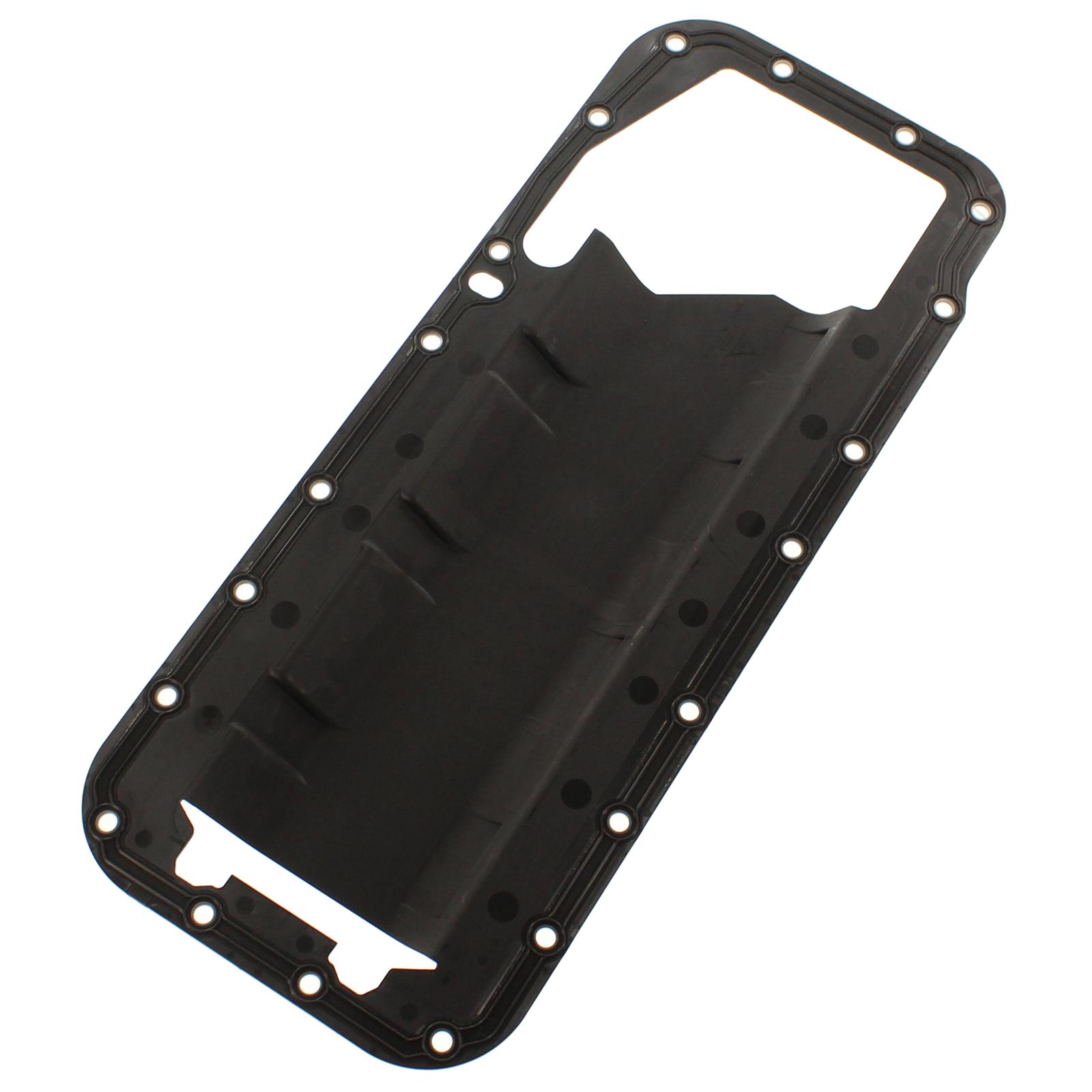

I bought that, and at high rpms the oil pressure would drop to nothing.
The tiny a-body bb pan didn't have enough volume for more oil, so I cut the windage part out.
Gasket held great for many years, until recently it started to leak. I checked the bolts to make sure they were secure and secured evenly.
Still leaks a bit, enough now to leave a tiny spot on the floor.
It's a nice design, flexible, two ribs running along and around the bolt holes, too bad.
Imo it's the pan to gasket seal that is the issue. I'm going for the, glue gasket to both surfaces approach, or just rtv.
