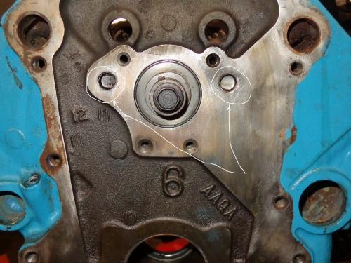

Or, look behind the camshaft thrust plate. There should be two oil galley plugs in those oil galleys. Some people think that they are not necessary, I had those two cause a problem on an engine that I rebuilt many years ago. Once I installed those plugs, my low oil pressure was cured. They wouldn't leak the pressure all of the time....
Here are the two plugs that I'm talking about:
