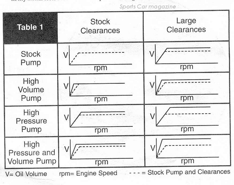

This illustration came out of an article I *think* from SportsCar but could have been North American Pylon. If I find it I'll provide the proper credit. Take it for what it is - a way to think about how the changes can effect volume. I would not take it literally. A lot will depend on the temperature (becaues it effects viscosity) and the relief spring's pressure.
When the oil is cold a high volume pump is not going to provide any more volume at high rpm than a standard pump. The oil is just going to be too thick.

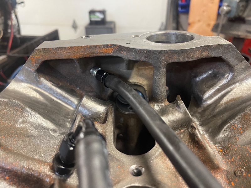

I think I have a couple of pictures of how I do it.
I clock the cam bearings so the home going from the cam to the head is blocked.
Then I plumb in oil from the oil feed to the pressure gauge port.
You now have full time oiling to the rockers. And it’s not taking oil from the mains to feed the rockers.
You do need to install a restrictor in the head under the rocker shaft or you will send too much oil to the rockers.
