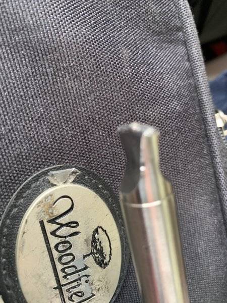

It was jammed really hard it bent the bottom of the distributor shaft I will try to post that. But once it was twisted and acted like a screw and screwed it self up against the clamp and then slam back down and that’s what the clunk clunk was.
