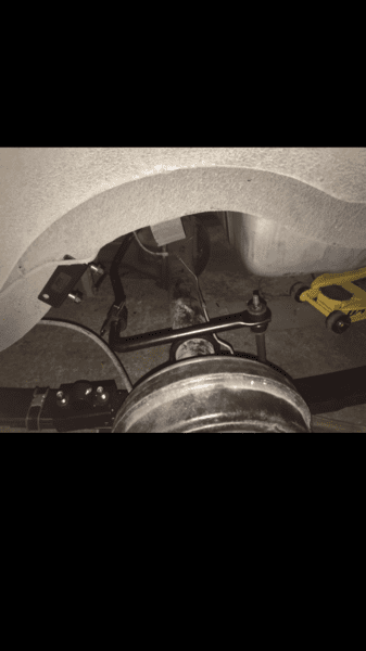

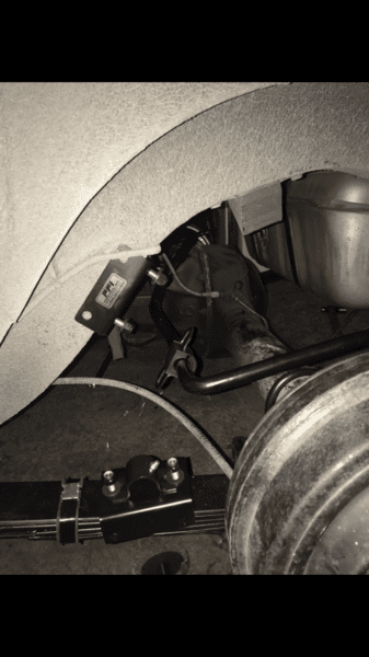

Here’s 3 pics from when I was installing.
I really LIKE how they made that frame rail reinforcement piece. That's nice. Looks like a high quality kit.
Yep, all the brackets are super solid like that. The front sway bar brackets are triangulated unlike factory with the dual mounting holes. And they have some LCA sway bar brackets that mount to the shock bolt for the end links as I have non tabbed LCA’s. The UCA are a nice unit. The plate that bolts on the spring for the rear end links in super nice also. It’s hidden by the drum, I’ll post some more pics tomorrow… the only thing that sucks about FF is the sticker shock, but their really not much more than the other guys…
