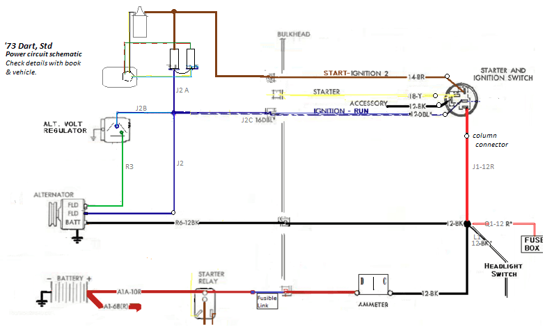

For how it works, see "isolated field" alternator this post Identifying Chrysler Alternators (1960-1976)
Standard wiring should look something like this.
Whether J2, J2A, J2B, and J2C are joined at single welded splice or some otehr way isn't important. They just need to be all connected together.

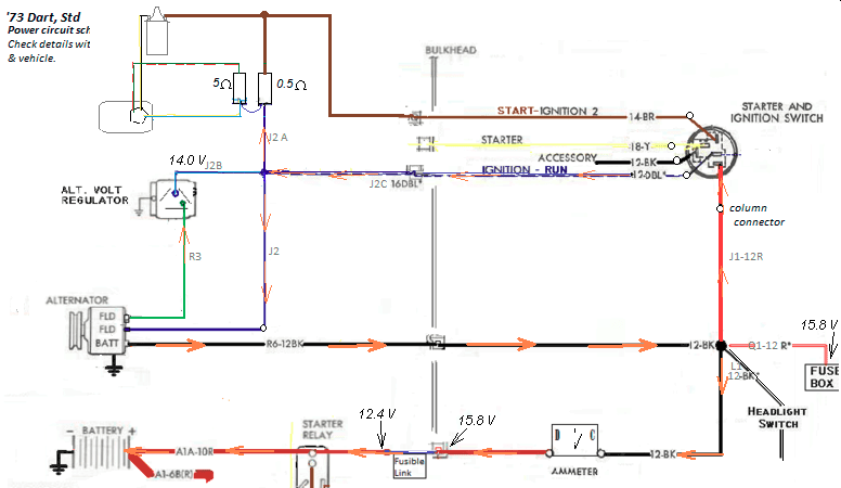

Here I redrew it so there's no crossing lines.
Only possible issue is the resistance at each additional junctions can add up. This could explain higher voltage output, but not the lower voltage at the battery.
What's the ammeter show?
15.65 V At the fuse panel when running . 12.38 at battery when running . not running battery around same and 11.48 volts at fuse panel
This probably has something to do with the regulator wiring. It has no idea the output is 15.8 Volts. it only knows what it senses. So if there are voltage drops between the output and the regulator's sense terminal, this causes it to try to bring the voltage up unit it sees something around 14.
If the regulator is sensing 13 Volts at its top terminal, its going to let more current through the rotor.
The 12.4 Volts at the battery with 15.6 at the fuse box.
I keep asking about the ammeter reading because this will reveal what is going on.
With only voltage reading, we can only guess.
So here's my guess. The battery is a bit low. Even if its normal low after starting.
At fast idle the alternator output is offering power around 15.8 Volts
The battery sees that and tries to draw 10 to 20 amps but enounters lots of resistance.
Some current gets through. Dunno how much, maybe 10 amps, maybe 5 amps. Whatever it is, the resistance is high enough that the voltage on the other side of the resistance is only 12.4 Volts.
Think of current like a river or stream. It divides at junctions to go to each way there is a path back to ground.
But it loses energy when it goes through resistance. That's the voltage drop. Its like the diffence between the power in the water coming over the top of a dam and the same water when its at the bottom.

Any difference between the 15.8 Volts at the fusebox and the assumed 14 something Volts at the regulator would be resistance in that curent path..
The connector in the column, the key switch itself, the bulkhead connector are all areas to check.
