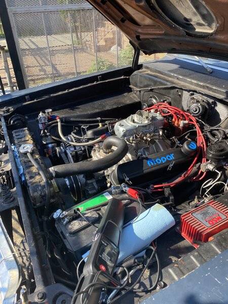

Ok, I’m old (39 in jPar years) but it looks to me like the carb main body is on the base plate backwards.
I haven’t done dope or booze since 01/17/1993 so I know I’m not loaded. Is it a camera thing or what?
Edit: when you get the main body correctly oriented you’ll notice you have the fuel bowls on the wrong end as well.
Alright so in layman's terms how do I fix it because honestly I’m 22 years old this is my first carbureted car and also my first engine build and I’ve never messed with trying to rebuild a carburetor in my life so a detailed explanation in laymans terms would be very much appreciated
