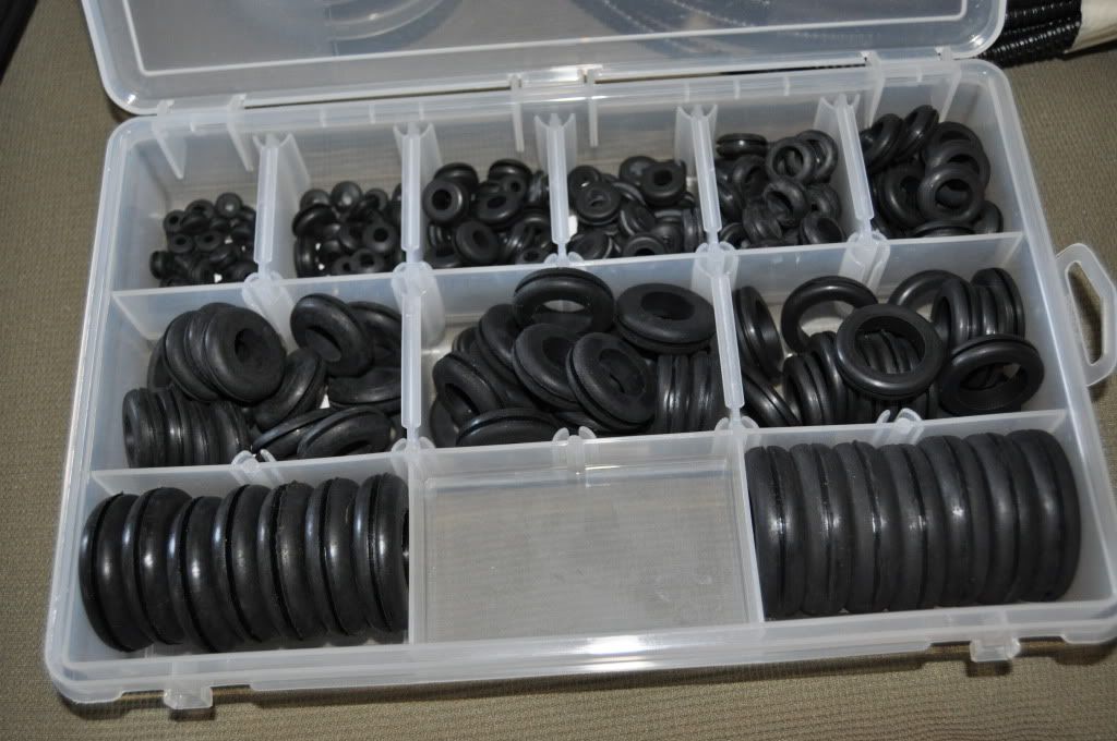

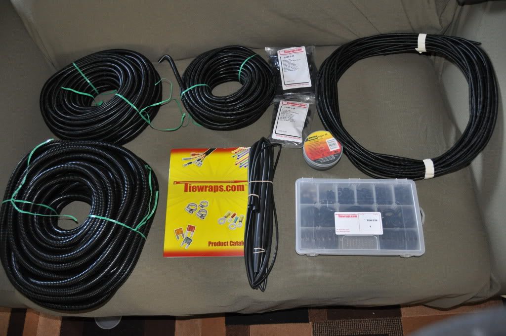

and don't forget all the other crap you'll need..
tape, wire ties, grommets, weather pack connectors, convoluted tubing, solider, wire terminals, connectors, heat shrink.... it gets crazy some of the crap you need to do it right..
here is the table with all my crap and ready to go..

i spent over $300 for the stuff from tie wraps.. i did order extra of everything so i have it for future stuff. the little terminals are like 50 cents each. we had to buy quite a few of them. then the kit then any misc. things i forgot about.. you can easily have close to $1000 into the rewire job. but its done and done right and won't have to be messed with again.. i also ran a wire for an electric fuel pump if i ever want to run one and for a/c under the hood if i want to run that..
