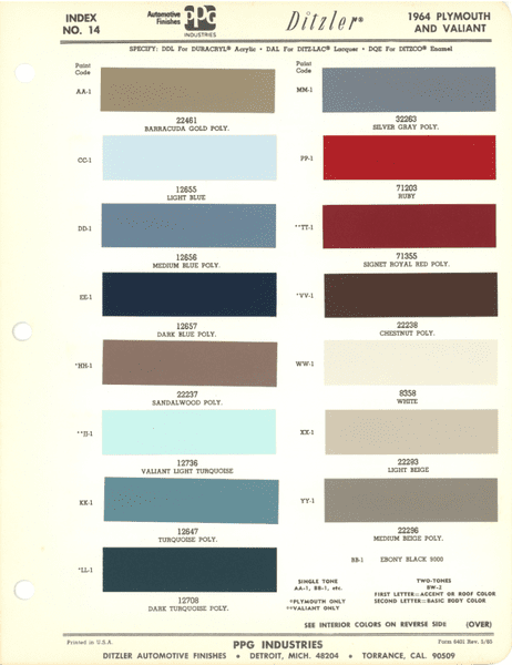

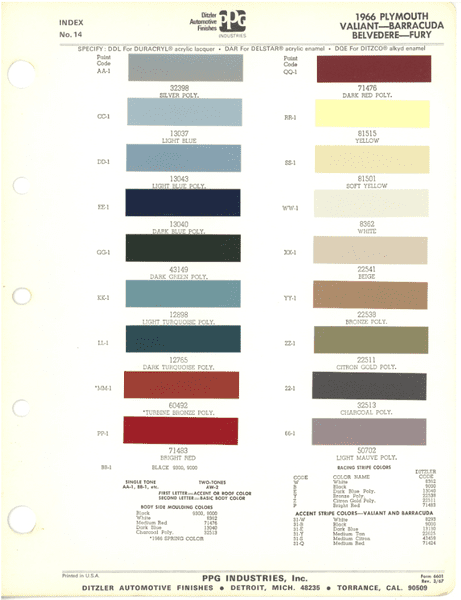

I pulled the 5 digit ditzler codes from the actual paint chip cards. The ditzler codes were different each year on those paint chip cards.
Here are the chips... 64 is 12708 and 65-6 is 12765...
For some reason in 64 the Chrysler LL1 is different than the 64 Plymouth LL1
Different code, different color, like said it might just be the metallic?
Alan
The vehicle-build paint codes (like LL1) stayed the same for many years to refer to "Dark turquoise", in this example. But what exactly "Dark turquoise" is varied as we see here. The paint-formula code (12708, 12765) defines what "Dark turquoise" is, exactly, for any given year-make-model.
