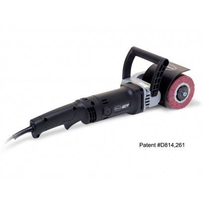

Have you seen the electric Eastwood contour sct surface conditioning tool. It’s a drum sander. Sometimes on sale for $199
Eastwood Contour SCT® - Surface Conditioning Tool

Thanks I will get one of those and try it out! I agree with the electric vs pneumatic. Pneumatic is great if you have a huge air compressor but one to actually run the way it should with DAs and sandblasted and even a good paint gun can cost thousands of dollars.
