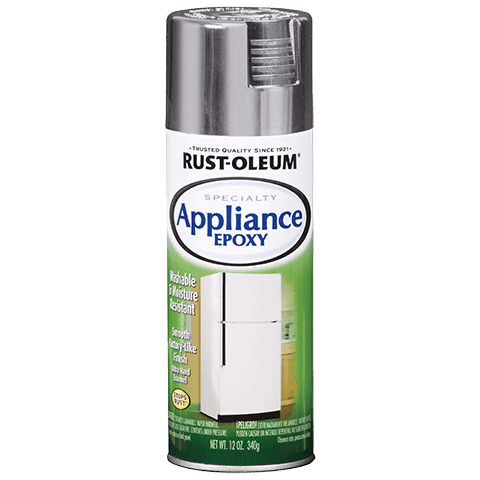

I did mine black with appliance paint, that stuff is pretty tough.
I think it is rustoleum.
