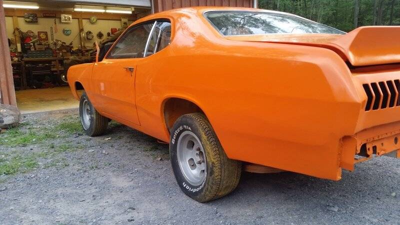

71 Demon /6 rust bucket - Now has a 340 short block w/ Keith Black .030 over, Engine Quest Magnum (Hughes worked) heads. Custom mechanical grind from Oregon Cam Grinding, Air Gap, Holley 750, 4500 converter, 727 w/ reverse manual cheetah, 4:88 spool. Added an 8 point cage, fiberglass buckets and hood.
Where’d you find that duck tail on your truck deck? I’ve been looking as I want to add one to my 73 duster...
Chrysler Nationals in Carlisle. It was cracked and most of the mounting holes were cracked through to the edge. I picked it up for $25. It's held on with panel bond, fiberglass resin and matting. I belive it is a Direct Connection model though.
