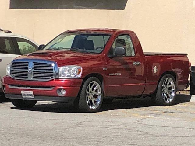

I just turned 350,000 miles on my 2007.
Bring that puppy to the East Coast salt/snow winters, Kern Dog.....lol. since the right side is worse, and I don't see that side as often, I decided to do one 45-is and one 90 to see which I like better.
