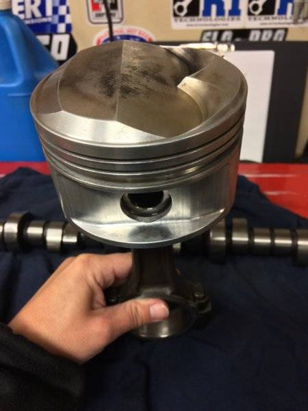

I always heard that with aluminum heads you can run 1 number higher on the compression with the same octane. That would put your compression at 13.1 equivalent.
Good luck getting that dome to fit an RPM chamber.
Gonna need a lot of whittling.
