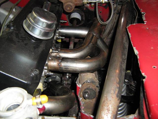

I found this out , but with W-9 heads and an AlterKtion.
Made them , and it was a 40 + hour , 850.00 chuckle fest............that includes coating.

If those are the same Dakota headers that I saw on a truck at pick-a-part, they kick out too far. They will run right into the steering shaft. They wont fit the passenger side either unless you remove the inner fenderwell and shock mount. #6 and #8 are side by side. You can barely get one pipe in there. Too wide...next!
Header selection for an early a sucks. My hookers cook a dual pot master cylinder. Best bet is buy the tubing, bends, and collectors and build your own.

That is not a job that is to be taken on lightly.
If you have the tools , skills and a high tolerance for frustration , I'd say yes.
Know that at least one tube a side is going into the wheel well in most cases.
The reason most of the shelf headers for these bodies are 1 5/8 " tubes and 3 " collectors isn't because they wanted to leave you room for easy plug changes.
It is tight.
Hooker's and a heat shield would not be a bad choice.
You will have them on and off the car a minimum of ten times a side during construction.
I have an AlterKtion ( no torsion bars ) and hacked up wheel wells , and I had 40 hours into them .........easily 40 hours.
