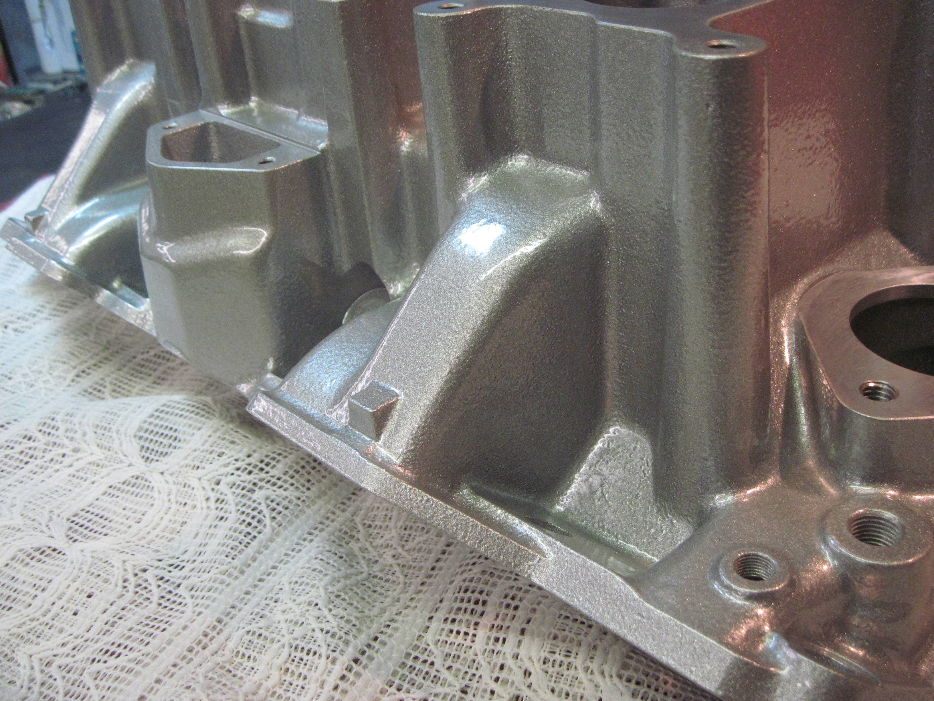

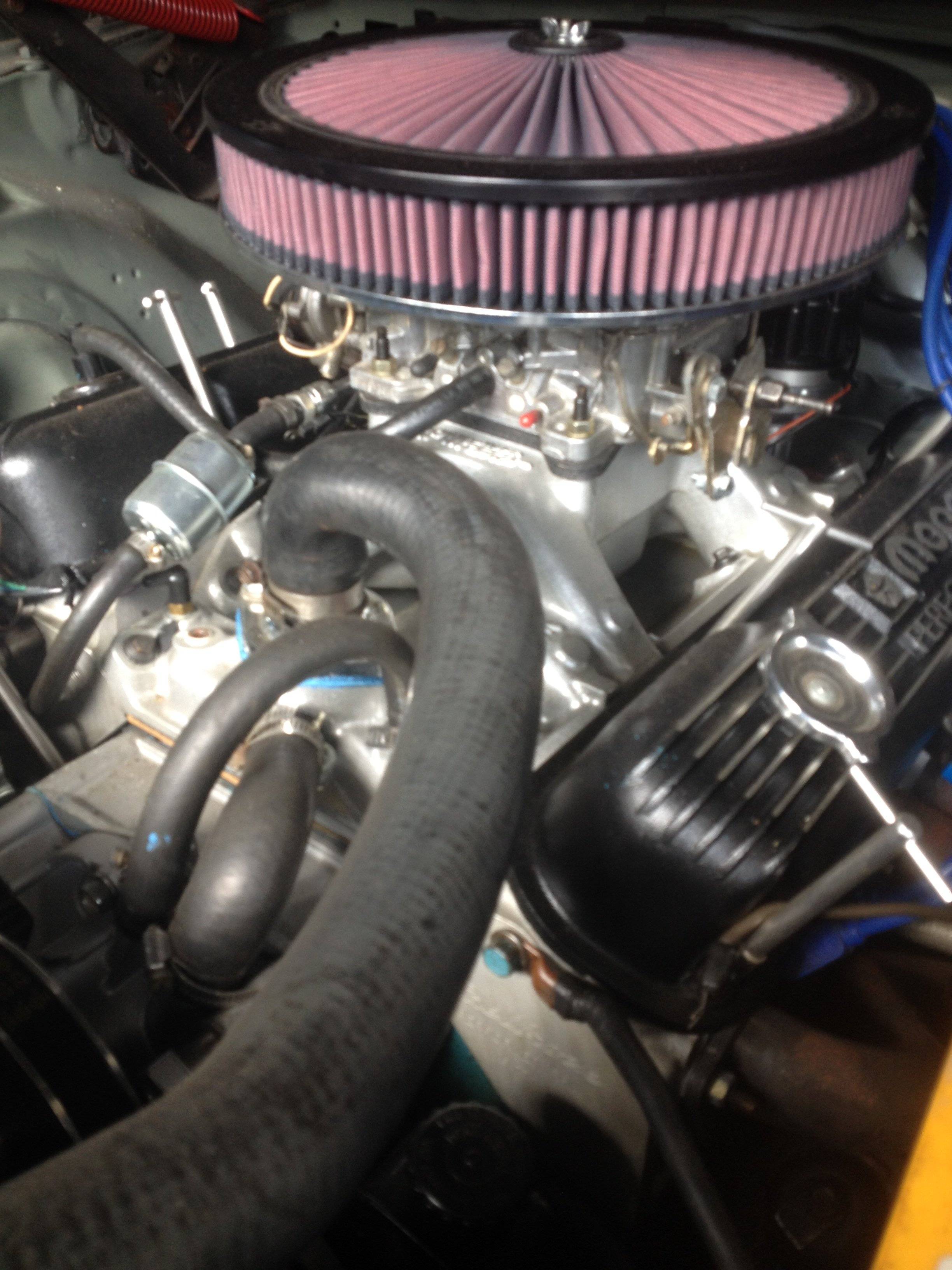

A few intakes LeAnna has done for me in Alien Silver.
