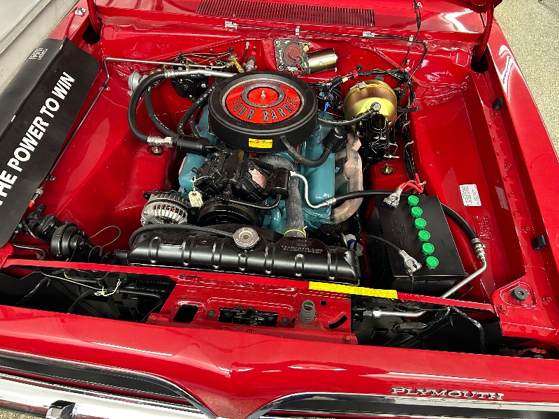

Pic is a small block '67 factory booster and drum brake master.

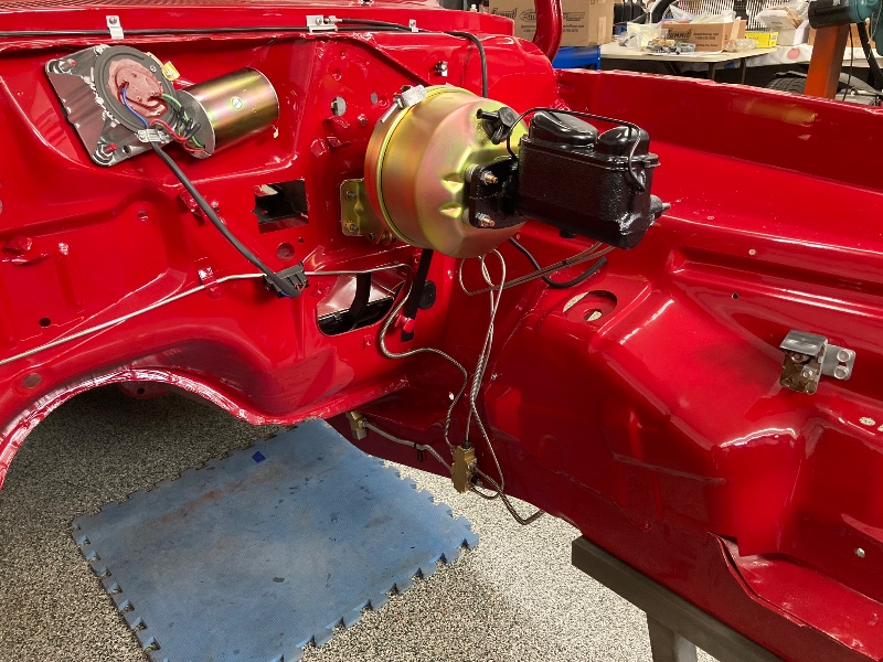

MC was installed on a spacer bracket in part to make it easier to get to the plugs.
Also, so the same brake pedal assembly could be used for power and non power brakes.
I wish they had done this on B body cars.
Repro boosters are available from several sources.
