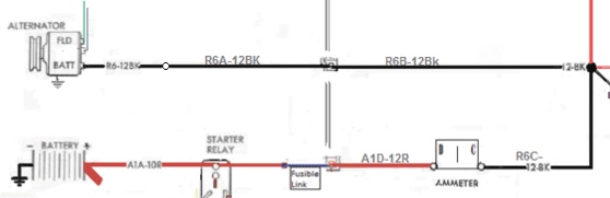

The red X on your previous post is because this is false
Alternator field goes through the ammeter.
No it’s not.
this picture is from your post. The ammeter just measures which way current is flowing. Either from the alternator or the battery.
It shows current flowing into or out of the battery.
Once the battery is recharged no current flows through the ammeter,
but the alternator producing power and the car keeps running.
The ammeter points to zero.
Alternator power does not flow through the ammeter - except to recharge the battery.

Okay, so I was right and your big red x wasn’t warranted. I said Exactly that. It shows which way current is flowing. Not sure why you x’d it or seem to be arguing the the same side of the same point I was making.
You don't understand. Let me phrase it differently.
The ammeter does not show current flowing out of the alternator.
The ammeter has nothing to do with the field circuit.
The OP asked about the field circuit.
I have one diagram (not a Chrysler diagram) which shows the power coming from the altenator field which I think is wrong.
You wrote.
That is incorrect.
The field circuit consists of the branch of J2 going to the alternator field terminal, the brushes, slip rings, rotor windings, and wire R3 to the regulator.
