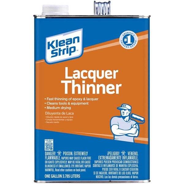

Klean Strip lacquer thinner, used it to clean my paints guns. It is a cheaper version of automotive lacquer thinner, it will clean and dissolve any build up your gun may encounter. Don't try to use it to thin your auto paint if you run out of the good stuff... hint hint.
I put that sh*t on everything. lol

Reducer or mineral spirits ain't gonna work for cleaning up any kind of epoxy type primers or paints. You need laquer thinner or whatever is recommended by the manufacturer for cleaning a gun. Steve
Laquer thinner. Jut that. Yes keep it off your skin also.
I was at HF today and a box of nitrile groves are now $23 used to be what $6? before the China bug shortage of gloves. I like the cheap gloves forhands when spraying but use better gloves for clean up. Yes nitrile gloves are useless with laquer thinner. BUT good ole HF had some good rubber gloves for like $2. They should last. Hate that place.
Thanks to ALL for your comments. I have lacquer thinner,so will go with it.
