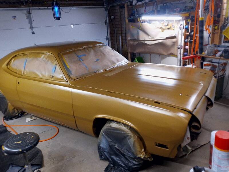

So far I have finished the color coat. It has taken almost two weeks to get this far. I now have 7 days to apply the clear to it.
In the past I have applied the primer,color and clear, in one day. Of course, I was never happy with it. Any flaws that may creep up from this painting will remain as long as I have the car. I am very lucky I have even gotten to this point.
