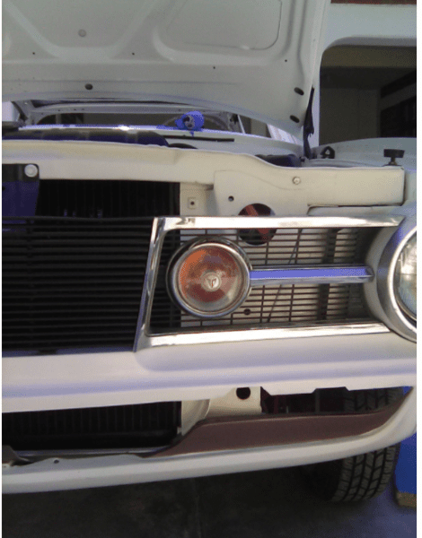

Update: Installed front and rear exterior lights and grille (not painted body color, went with SEM trim black). On the front valence, I put some rubber "washers" over the holes before setting the parking light frames and grille down on top. Granted, not the best idea for establishing an electrical ground.

After the front parking lights were assembled in the frames, I shot one coat of Rust-Oleum clear on the backside of the chrome pot-metal light housings. I had previously cleaned them up somewhat and figured this might help keep 'em clean. The area behind the front parking lamps should be black (saving that for another day).

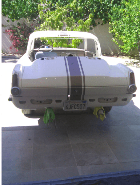

Could not find the screws to attach the rear tail light and reverse light lenses. I ended cutting down some #8 wood screws. For the reverse light lenses, I used the gaskets that came with the repro lenses (black in photo) which were a little smaller/better fit than the slightly larger/thicker DMT gaskets. I had to use nuts and washers for the tail light housings, still searching around here for the mis-placed nuts with captured washers the factory used.
