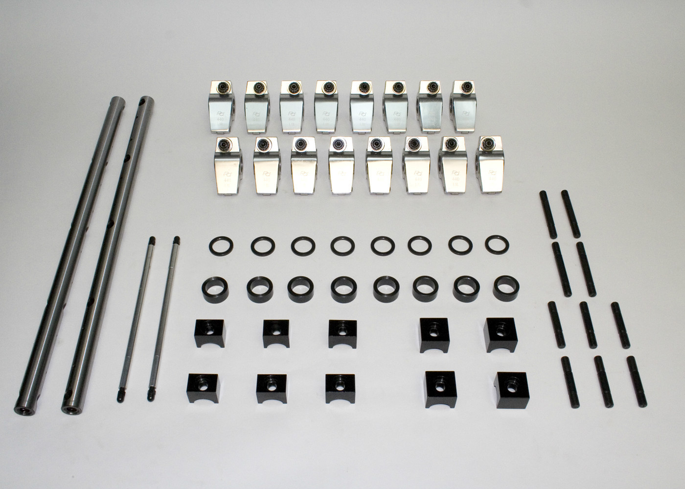

Are they the stainless or aluminium rockers?
Aluminum PQ series
Look like this pic
