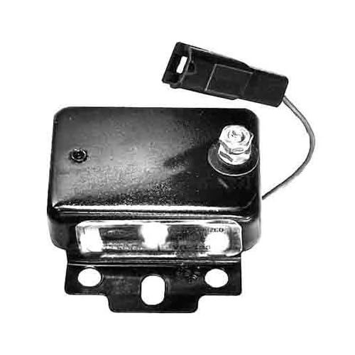

This link is a more expensive replacement regulator
http://ecx.images-amazon.com/images/I/41-aG0961CL._SL500_SS500_.jpg
