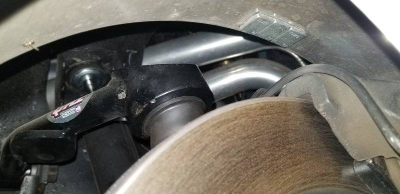

I'm running a 17x8 Torque Thrust 2 with the QA1 uppers. I'm pretty sure my backspacing is 4", or right around there. No clearance issues to the wheel. I don't have any pics, but if I remember I can snap one after work today.
Appreciate it. The backspacing is about 1.5" less than my wheels, but a picture should be good info anyway.
Not the best pics, but there is about 3/4" of clearance between my wheel and UCA. I'm running an SSBC disc conversion up front, I dont know if that changed my WMS-WMS measurement at all. And I'm pretty sure they are 17x8 with 4" of BS.
Thanks for the pictures.
Tripped over this post with pictures of a 17x8 wheel with the same backspacing as mine. While the UCA's look like Firm Feel ones (I would reseach and verify, but can't right now), it does give a fair guess at how the QA1's would interface with my wheels.
Thanks all for the help.
