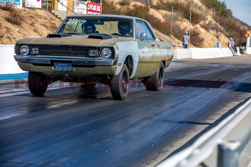

Do you happen to have a picture of your car at rest? Curious on the amount of lift.
You would think I would but I can't seem to find a good side shot. Here's one where I had the slightly smaller street tires (P295/55R15's) on it. Not sure the pic helps. If I had to guess, I'd say the body probably lifts/separates about 3-4".
You would think I would but I can't seem to find a good side shot. Here's one where I had the slightly smaller street tires (P295/55R15's) on it. Not sure the pic helps. If I had to guess, I'd say the body probably lifts/separates about 3-4". View attachment 1715828795

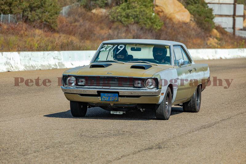

Thanks, that works! Here’s mine with Caltrac’s and SS springs. Thinking I might go with their split mono’s.
The amount of separation will vary some depending upon how tight or loose the extension setting is on the rear shocks
I guess I was curious if there was an inherent difference in design that impacted lift. I pulled the spring clamps off the back to encourage separation on my SS springs and wondering if CalTracs has a different philosophy. Guess it’s time to make a phone call:p
