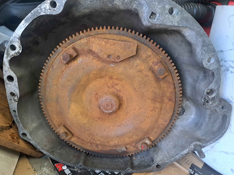

I have a QQ: I'm using this 727 behind a 5.2 mag engine, I know these motors are internally balanced. I have this torque converter id like to use and not many other options (older looking one with a drain plug? in it and no weight is my other option)
Should i use this and knock the weight off it? Anyone ever removed a weight off the tq converter? is it hard without ripping the skin on the converter? Do i need to grind slow till spots are broke or can I just take some big ole pliers and yank er off?

The torque converter is neutral balance with that small weight. Then the large weight is added for the external balanced engine.
What I have done in the past was carefully cut the large external balance weight off with a cut of wheel. Cut down into those 2 spot welds being careful not to cut into the converter housing, The area will get weak and you will be able to pry the weight back and forth until it comes off. Once you have the weight removed smooth the weld area with a flap wheel . You now have a neutral balance converter.
Once you get that weight off using the procedure Steve mentioned above, lay the flex plate from the 5.2 up against the converter to match the holes up. You will see that you have to oval one hole out to fit. If you aren't using the fuel injection that came on the 5.2, you may be able to use the flex plate from an LA motor, that matches that converter. If it were a 5.9 Magnum, you'd be stuck using the 5.9 Magnum flex plate because they are external balanced and the weight is on the flex plate vs being on the converter like yours is.

There's only one weight on this converter, the other flap looking thing is a sticker that says "LS LOCK UP" which I also have no idea what that means! HA!
I figured I needed to get this off, thanks for the direction in this area! Seems I was on path!
This is correct and I have my flexplate off a 5.2 FI engine that I've marked to oval a hole on. I will also need to cut the trans a bit for the sensor to read it's triggers =)

There should be a weight on the outside Diameter then behind the ring gear then. Even if not, removing the large weight will make it neutral balanced
I think this is the only weight on the whole converter, I will work on getting it off as I put the trans on a stand to adjust bands and reseal =) Thanks again for the infos on this! Much appreciated!
I honestly don't know if there's such a thing as a 727 lockup style transmission or not? They made a 904 lockup trans that was designated a 999, so it may be possible. Post a pic of the input shaft of your 727 and we can see if it's a lockup.
