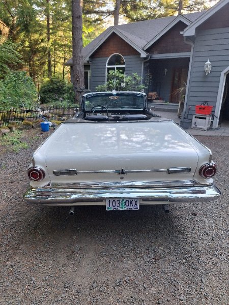

I'm looking to buy a set of original 14" rally wheels for my '64 Dart GT convertible, to replace the stock 13" wheels and hubcaps.. These have the correct lug spacing of 5x4". I think they should bolt right onto my hubs.
I'm looking for a size the would serve well for just cruiseing and car shows.
What tire size would you suggest?

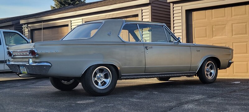

No wider than 7" with a 4.5" backspace in the rear. 6" on the front (the factory wheels were 5.5") 2.25 60's on the rear work well. 185's on the front. Bigger ones may work but you may have to trim.

Pic of my car as is attached again.

LOTS of 14" tires on the market still. I would say either a 205 70 or a 215 70 would be fine. The 215 70 might require a very small trim on the inside of the bottom front part of the wheel well.
my duster I run 195/70R14 on the front and 225/70R14 on the back. if you want the same size all around I'd probably go 205/70R14

the factory 14" SBP rims on my '76 duster were only 4.5" wide, stock tire size was D78, which is roughly comparable to a 185/75R14....realistically the widest tire you probably want to put on that width rim if that's what you find is probably the 195/70's.
one thing to consider, if you wanted to swap looks easily is to get factory 14x5.5" rallye wheels, take the trim rings and centers off and you should be able to run full 14" wheel covers, you could swap back and forth between the rallye wheel look with the centers and trim rings, and full wheel covers as your mood dictates....
The original wheels were 5 1/2 inches wide and the current repops are all 6 inches wide. Suggest that you measure what he is selling. They would both fit on a 67 and up car, not sure about an early A-body...
