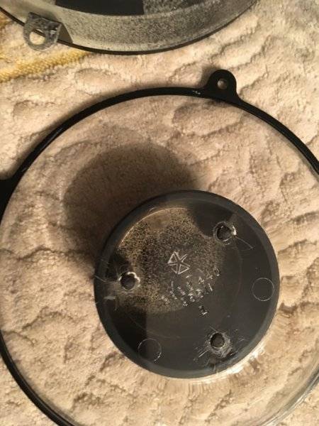

Finishing up the re new process on the rallye dash.
Concerning re attaching the plastic pegs that hold the lenses and the lenses centers in.
I have read posts where folks said they re melted the plastic peg with a soldering iron,
I am guessing that one would need to add a small amount of plastic to the existing peg ?
What kind of plastic does one use? Can someone add a few details on how to do this.
Although I have also considered putting a drop of plastic epoxy on the end to fashion a cap to the existing peg, see any issues with doing the assembly that way?
thanks

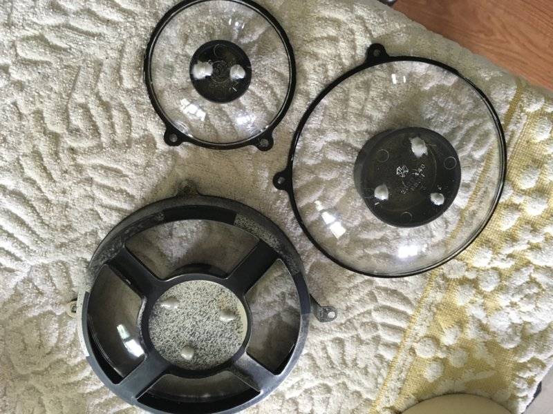

I went with the JB Plastic Bonder, I put a small drop on top of each peg, to give them a bit more height, let set, then assembled the pieces and put another
larger drop on each one. So far, all is good.
