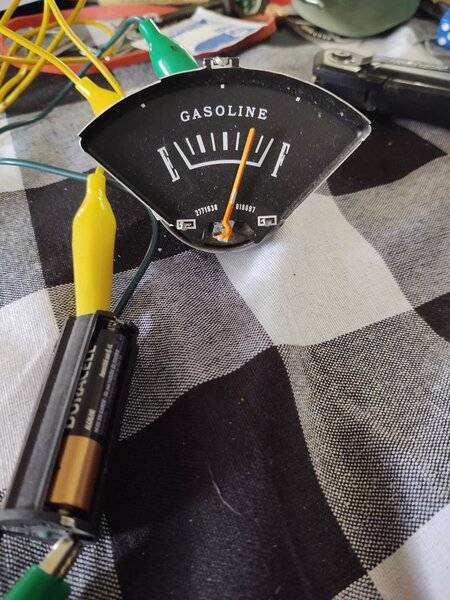

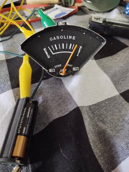

I have a couple of extra clusters//I'll put some voltage to it tomorrow to see if it works// $40 sound to much if it works ?
That gauge has the voltage limiter inside it. testing would include the limiter with a 3 gauge load on it. Or just plan to replace that limiter with solid state regulator. Good luck to all.
3 AAA batteries and two test leads 4.5 volts//
