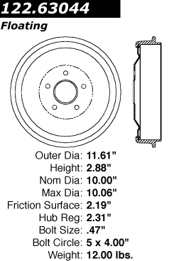

I am trying to find rear brake drums for my 1967 Plymouth Barracuda. It is and 8 3/4 rear end with 10" by 1.75" drums. I am unable to find these drums on rock auto or classic industries. Does anyone know where i can get 10" by 1.75" rear drums?
Nominal 10" x 1.75 Drums for the 5 x 4
Centric p/n 122.63044
These are their standard drums. Functional. OK quality, made in China.

looks like 5x4.5 bolt pattern per the link in the post
Yes agree 5 x 4.5 were on the linked page. Need to go the first pages of the thread to find the 5 x 4 bolt pattern info.
Found a Source for 10” rear drums with 1-3/4” shoe
The Centric premium are NLA - maybe forever. While waiting for the new drums had my old (but not original) drums lightly cut and the shoes arced to match.
