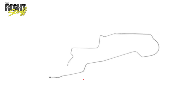

Thank you guys for the advice. I have some experience double flaring because I re-did the lines that go from the "T" to each drum wheel cylinder. I just wasn't aware if I could do the same to this line because of the spring like external protector. I would never try to cut costs on brakes or anything critical but it would be such a job to reroute this rear brake line from the front to the rear "T". If I were to buy the line, is this the right one? Thanks guys

Does this line you need come from the front of the car or from the tee fitting to rear brake cylinder?
Not hard to replace front to rear OR it may go easier rear to front on some cars.
Can't say if the one in the photo is right without a part number.
Anyway. just take your time and all will be fine.
The line I need comes from the front of the car and goes to the tee fitting. I replaced and flared the lines that go from the tee fitting to the rear brake cylinders.

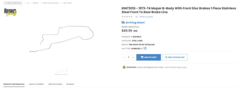

Here's a better pic, sorry about that.
Looks like his line needed is the rear brake intermediate line. Not the axle housing line...
Zero chance you should re-use that TUBE. And you should take a very jaundiced look at the rest of the tubing, as well. I recently replace all the brake tubing in my 04 GMC which otherwise is very low rust. The tubing was a mess. I would guess that GM's recent choice of non-protection for the tubing was a factor. Worst looking tubing of any vehicle I've ever owned
The stores have various lengths, which are softer and easy to bend. You can also buy bulk tube various places, likely not locally
Okay thanks for the additional advice. I will replace that entire line. I already have maybe 3 or 4 feet of the copper/nickel tubing because that is what I used when I replaced the axle housing brake lines but it looks like I'll need more. Do I need to keep that flex hose that connected the brake line to the tee fitting or can I go directly to the tee fitting with the nickle/copper tubing? Thanks everyone
