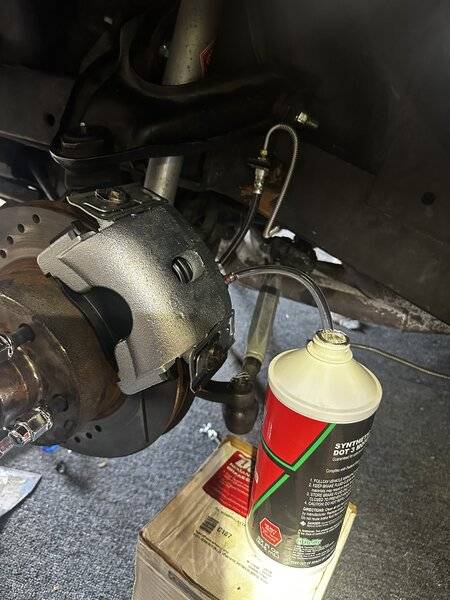

Rear brakes are not bleeding.

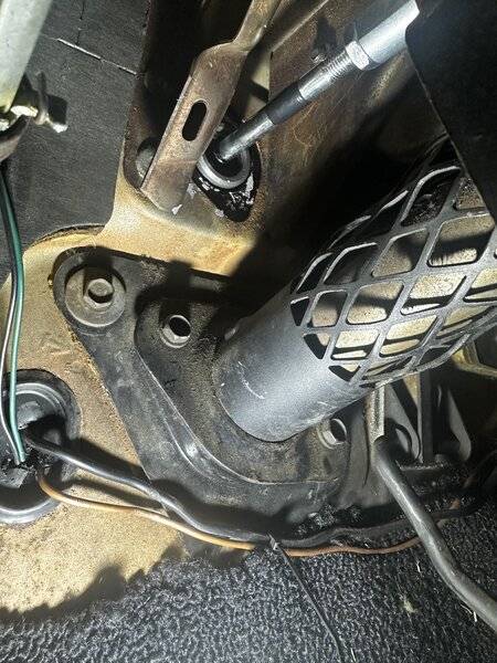

Sounds like the pushrod is too long and isn’t letting all the pressure off when the pedal is released.
Yeah that’s what I’m thinking now. I’ll try the method for measuring it that just send it posted. Pressing the pushrod in is a pain in the *** while the MC is on the car though

The pushrod was correct length on the vice, but I’m assuming now that it is on the car, because you have the firewall and the adapter in the way, I don’t think the pedal pushes the pushrod all the way in. It needs to be adjusted longer now.
I did everything right, hooked it all back up correctly and then when going to bleed the brakes (because the MC was off the car) the pedal went rock hard and wouldn’t move anymore after 3 pumps.

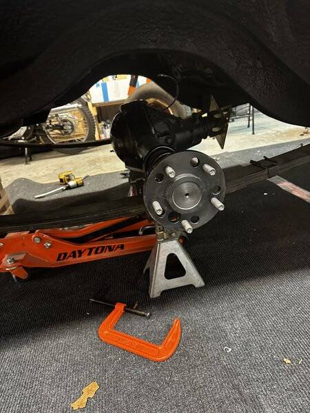

I grabbed the new rear disc brake kit with bleeder screws in the proper 11-12 O’clock position and the proper rear line location on the housing with the distribution block.

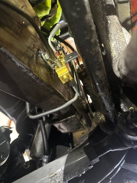

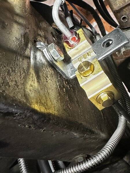

When you assembled the distribution block, how far did the Switch screw inside of the housing? Any chance that it's too deep and is obstructing the fluid path to the rears?
You should be able to use the original factory length for the brake pushrod. I know I run the DoctorDiff mastercylinder and adapter with a factory manual brake push rod in my Duster.
This thing has got me stumped. Especially the hard peddle. That tells me that fluid is being hung up somewhere.
I thought of the switch being an issue, but honestly I didn’t screw it in or unscrew it.
The only thing I can think of at this point is - the old car used an old GM type distribution/proportioning block/valve without a mopar style distribution block on the 8.75 housing.
I’m using a mopar 4 wheel disc brake block without using anything on the 8.75 housing still. So maybe fluid isn’t flowing to all 4 corners evenly? Or maybe it needed the GM style proportioning valve to do the rear brakes correctly.

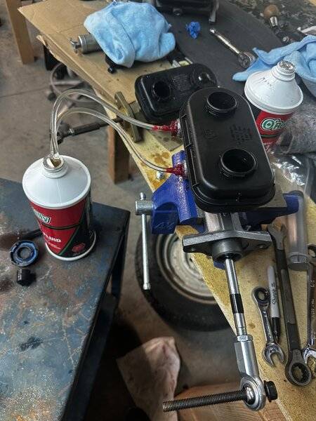

I mean I’m not the smartest guy in the room that’s for sure but the rod goes in all the way and comes out all the way when I get to pump it. But after 3 pumps when I say the pedal gets hard, it gets hard while having the pedal and rod all the way out, making it nearly impossible to depress the pedal without using a ton of force. Then it kind of slowly depresses and will have a couple little parts when it jumps down quickly. I’ll video it in a bit if it happens.
I’ve bled the MC multiple times, on the car off the car and with 2 different MCs.
I always follow these processes so….

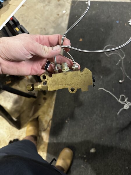

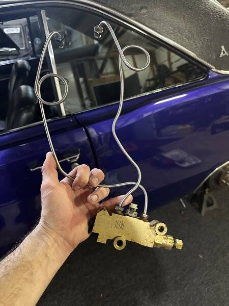

I’m really thinking this is the problem, not using the GM prop valve. From reading it does distribute the pressure to fronts and rears. Which in theory could explain that after pumping a couple of times I have fronts that lock up and rears that don’t. Because more fluid should be going to the front than the rear with the GM style setup.
Check out this page from Summit Racing Summit Racing SUM-760183 Summit Racing™ Brake Proportioning Valves | Summit Racing

Sounds like you're compensator port is plugged or blocked. If the port is open there is no way for pressure to remain in the circuit as the compensator hole provides a direct path to the atmosphere via the reservoir and vent in the cap. Try to loosen each line and observe which line has pressure on it or if both do. Where there is pressure there is a blocked compensator port. if for some reason the piston is not returning all the way it won't take much to block the port.
I just had a wilwood cylinder with a deformed cup seal (probably caused during assembly) that when it rotated to just the right position hung over the compensator port blocking it. The compensator ports are placed very close to the end of the cup and are very small to minimize the lost travel at the pedal that you feel until the cup passes over the compensator port and begins to build pressure.
A working compensator port can sometimes be observed by looking in the reservoir while the pedal is depressed. Wear safety glasses so if fluid squirts out of the reservoir it doesn't get in your eye. Shine a flashlight in the reservoir and look for the compensator port. Have someone depress the pedal slowly you should see fluid movement out the port as the piston moves toward the port. When the piston arrives at the port covering it up the fluid movement will stop and the pedal will get hard in a properly working system. Another thing that will happen is when you are bleeding brakes and you have air in the system. "Pumping the pedal up" will compress the air in the system and if you release the pedal wth air compressed in the system as the pedal is returned and the piston uncovers the compensator port the pressurized air will push a geyser of fluid out the top of the reservoir. if for some reason the piston is not returning all the way it doesn't take much to block the port.
GM Disc/Disc Proportioning Valve for 1/2-20, 9/16-18 Outlets
If you want to test that theory cap the lines going into the porportioning valve and see if your problem persists. I would encourage you to verify you have a properly working master cylinder first.
It shouldn't matter at all which prop valve you have, if any. At least not for the issue you're describing. The mopar prop valve does the same thing.

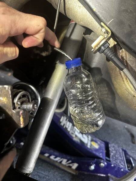

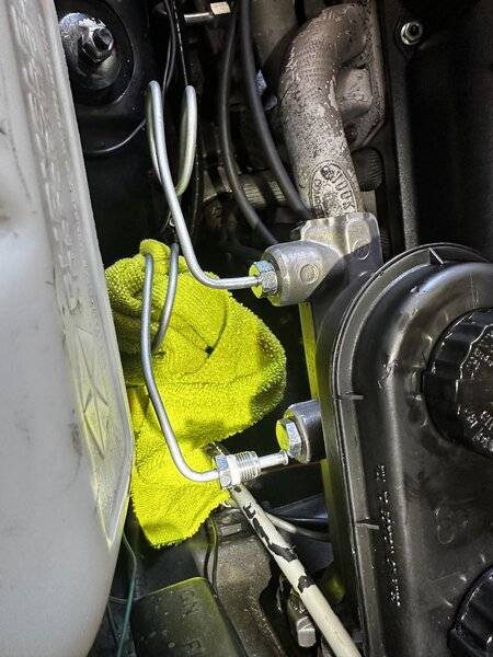

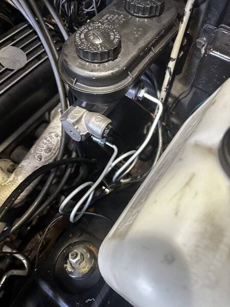

When I cap the front port of the MC (line that takes fluid goes to rear brakes) fluid comes out of the MC with ease.
While the front port is capped and fluid is allowed to flow out of the bleeder screws at each caliper (passenger and driver) fluid flows out of the bleeders with ease.
When I cap the Rear Port (line that directs fluid to front brakes) fluid comes out of the MC with ease.
While rear port is capped and fluid is allowed to flow out of the distribution block to the rear brakes, fluid flows out of the distribution block with ease.
I haven’t tried it at each wheel yet but… I think this means my MC is working properly. Although it definitely needs bled again after shooting fluid straight out of it and bringing fluid right back in.
did it anyways.

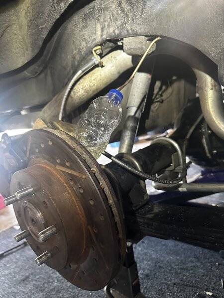

Capped rear port on MC (sends fluid to front brakes) and pressed pedal with main line detached from each rear caliper; first passenger side then second drivers side. Fluid comes out of the line with ease.

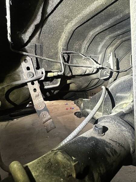

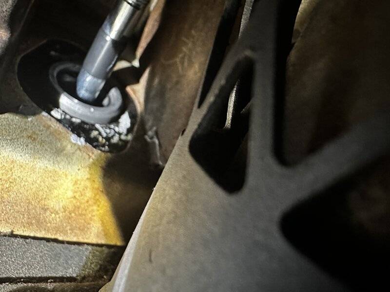

So… culprit is one of the rear calipers I would assume?
First picture is the passenger side hard line broken from the soft line and the second picture is the drivers side hard line disconnected from the soft line.
