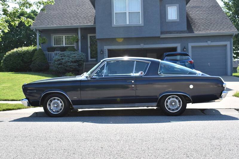

    My '66 Barracuda has had air shocks lifting the rear since I bought her. I've never been a big fan of air shocks but the car was running fine so I didn't worry too much about them. Yesterday I noticed the car was sitting at about stock level ride height. I tried to put some air in the shocks but I can hear it hissing and it immediately starts falling back down to stock level.
    I'll post some pics of before and after the air shocks went bad.
    I need some info (I'm a bit of a novice) on what my alternatives are in getting the ride height back like it was with the air shocks but without the air shocks. I contacted Espo and they can do leaf springs that are a +1 or a +2. I can't tell from the pics if a +2 is going to be to high or if a +1 will be lower than I want. Has anyone used a 5 leaf spring with the +2 inch option? Does it get the rear height at about where mine was? DSC_0603.JPG DSC_2567.JPG

      It looks like about a 2" difference. Now if the sprAngs are worn and sagging from stock, that 2" + spring may raise it too high.

      Then leave it like it is and put regular shocks on it.

          Oh so you want it higher. OK. Just fix the air shocks. An air line probably got onto an exhaust pipe. Get under and actually look at something and you can figure it out.

              Looks like +2. If you want to get rid of the air shocks I’d go +2 and if it raises it too much you can either flip the front hanger or put a lowering block btw the spring and axle.
              btw to me the stance looks better in the second pic.. Jmho.

                    I like your 2nd photo better than the 1st. I'm not a fan of air shocks myself. If you want more of the stink bug look, I'd either get some new springs with whatever height you seek, add a helper spring, or put on some coil-over shocks. Keep in mind that some coil-overs have too big a diameter spring that will rub on the fuel tank. You may have to look at a few first to get ones that fit right without rubbing anything.

                      I do too! It looks a lot better to me sitting stock.

                      I'm torn over what to do. It looks nice at stock level but I also like the raised rear end look too. The easiest option would be to just fix the air shocks. But I think I would be happier with standard shocks and have the leaf springs adjusted to give the rear a boost. If I put standard shocks on and drive it some I may wind up liking the rear at stock level and just leave it like that. I'm gonna put a lot of thought into it this weekend and hopefully figure something out.

                        Looks like the problem I'm having with the air shocks comes from the driver side hose getting to close to the exhaust pipe. The pipe burnt a small hole into the hose. The shocks are a pair of Gabriel HiJackers part number 729706. Does anyone know of a place to get a replacement hose? I'm digging around the internet but there's a lot of different part numbers I'm seeing and I'm not sure which is compatible. Thanks.
