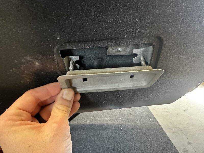

I have the 1969 Dart AMD rear quarter panels and the aftermarket side marker bezels.
The side markers have a different style to connect to the panel. They have a stud instead of the machine screw into the captured nut.
I am at a lost as to how to fasten the bezels to the panel. The studs do not line up with the brackets in the panel and they look to be too long to get a nut on the inside if you drill new holes.

You are trying to put front bezels one the rear. The rear bezels have no studs. They have holes, and attach with screws, before the reflector is stuck in. There are two small U clip slid onto those tabs for the screws to thread into. You also need to lengthen the slots a bit.

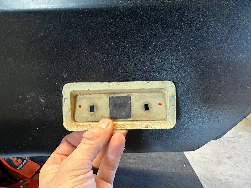

This is what I was thinking, with captive nuts like OP.
Studs cut off and Holes drilled where red dots are. Add captive nuts (1/4 or M8/M10) then bolt together
I suppose modifying them may work, but using correct rear bezels would be better. I think the angle of the reflector is different front to rear. If you do drill holes. don't put them so far apart. You want to be able to slide the U-Clip onto the tab. Move your holes closer together and just lengthen the slots about 1/4"

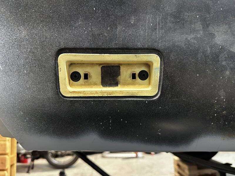

Messed with it tonight, I had a bezel with one tab already broken so chopped them off. Just lengthened the slot a little. I was going to use 1/4 bolts but they only had 1in long bolts at Lowe’s last night, used 10s with a trim screw.
The bad part is that the tab on the right side (towards the front) prevents the bezel from sliding towards the front of the car anymore.
