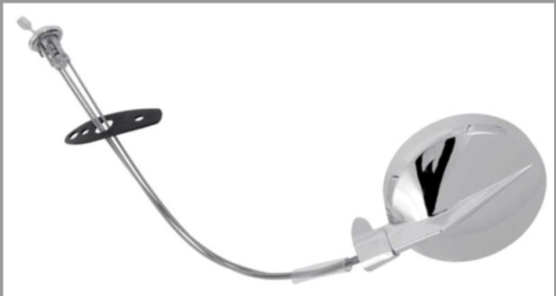

So I bought remote mirrors for my 1970 duster that were supposed to fit 66-74 a and B bodies from classic industries (md2207) how ever the remote cable looks like it’s about 6” short of being able to work.
Can you change out the remote cables on the mirrors or does some one sell a mirror with the correct cable length?

Looking for the bracket or what ever was used to route the drivers side mirror cable away from window glass for my 1970 Plymouth Duster.
