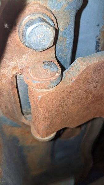

Technically yes. ASSUMING.... there is room for the pin to move all the way out, AND you have room to strike or press it out.
Why not unbolt it from the door?
I recently did it in a wrecking yard with a box wrench, took forever but since I could not open the door all the way I could not get a socket in there.

I think you could. Fibre cut off wheel. Grind the head off and drive it out. If you find some interference cut that off too. Corrosion and the sheer weight of the door could be your enemy.

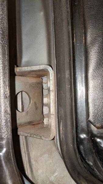

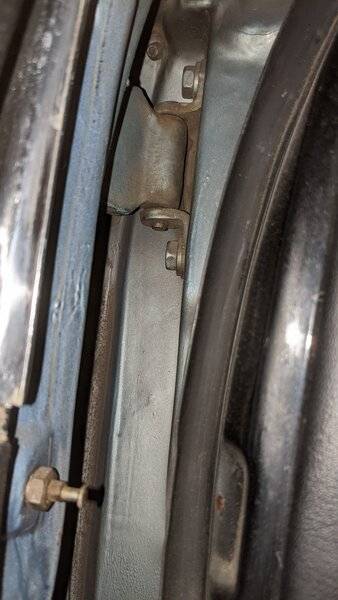

Open the door and remove the two bolts closest to you on the lower hinge to door ,Then roll down the window and close the door.
Remove the splash shield behind the front wheel to access the front of the door while it is closed. From this location you can remove the upper bolts to door and also remove the last lower bolt through the access hole in the hinge.
Once these three bolts are out just open the door while holding it securely and the door is off. One person job doing it this way.'
Using shims on the sill to hold the door up it can also be installed this way.
