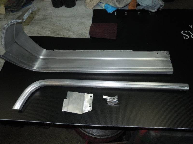

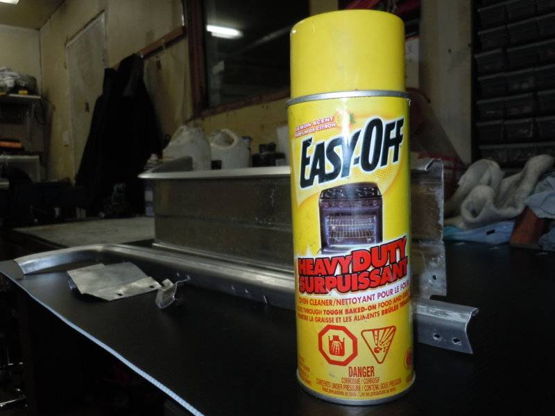

Eazy-off oven cleaner works great! The trick is to leave it on long enough . I left it for 3 hours! Wash part well after. Then use a green scotchguard pad or steel wool to finish. I actually buffed my grill parts afterwards with three types of compound and then waxed them. Came out great!
Eazy-off oven cleaner works great! The trick is to leave it on long enough . I left it for 3 hours! Wash part well after. Then use a green scotchguard pad or steel wool to finish. I actually buffed my grill parts afterwards with three types of compound and then waxed them. Came out great!View attachment 1715286356 View attachment 1715286357 View attachment 1715286358 View attachment 1715286359 View attachment 1715286360
Hello DBL A. Thanks for the pics along with the information. A good start. Appreciate your time and response. sgrip65

I tried the yellow can heavy duty easy off, and it works great. Thanks to all for the advice. Much appreciated. Thank you. sgrip65
No problem sgrip65! Glad I could help. Don't forget to thoroughly wash the parts after the Easy off, if you don't get it all , it keeps on working if you know what I mean!! LOL!!
