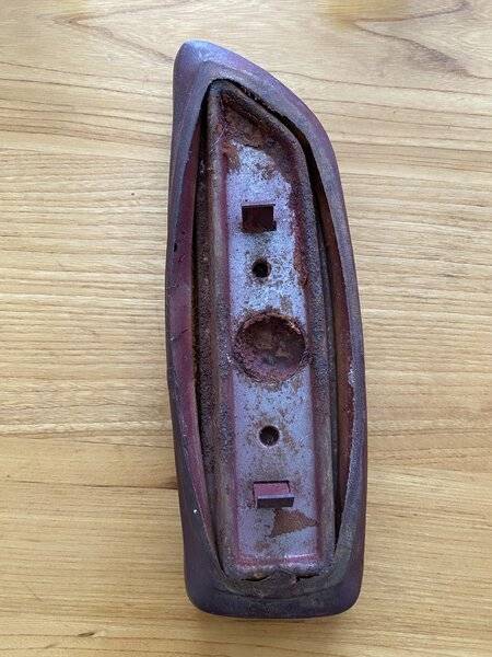

The sides of my rear arm rests have separated from the metal core and have pulled away. Is there anyway to glue them back to the metal core?

Here's how I would TRY to fix those. Remove the cover completely from the metal bases. CLEAN the inside of the vinyl THOROUGHLY. Same with the metal. I would use a wire brush on a grinder and get ALL that rust off. Then, I would paint the bases with something like a direct to metal paint. Rustoleum industrial oil based paint comes to mind. Finally, I would get 3M Yellow Weatherstrip adhesive and apply it to the insides of the covers. Slip the covers back over the bases and use several long, wide, heavy duty plastic zip ties and tie the cover on tight and let them dry for several days. They likely will never come loose again

Oh and one more thing. Don't make the mistake and use the 3M black weatherstrip instead if you decide to go the route I described. It is nowhere near as strong and I've never seen it dry completely.

All of mine look like that. I also had a tab break off one of my originals back in the 1980s. I was able to use a screw to hold it on. I will probably attempt to fix mine. I like black rtv for a lot of things and will probably try that.
