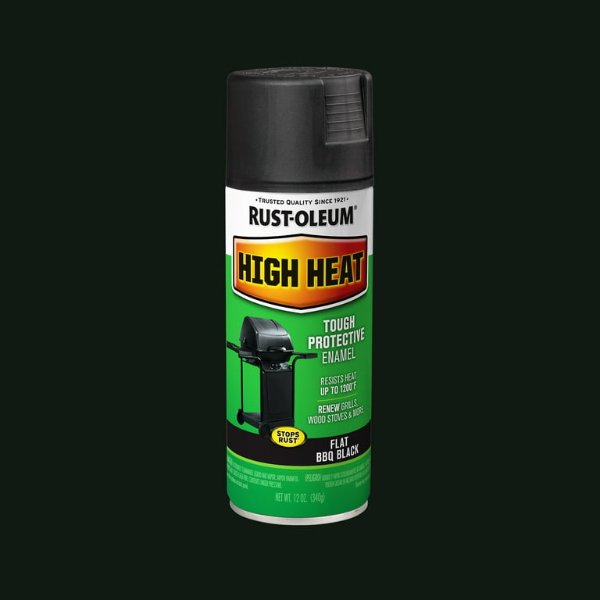

Make sure you get some cheap satin Black paint and lightly paint the core on the front side so you don't have the awful aluminum radiator behind the grill look.
I believe there's special "heat dissipating" paint for radiators.
ive used those and they dont impress me, and they have peeled off of every tank i have sprayed them on, thats why ijust started doing the core on th front only. Seriously i use the cheapest satin black paint i can find and just mist it on enough to change the color. A thin coat is all you need on the core, the more paint you put on it the less air can get through. The real cheap paint seems to be super thined out and coats it nice and lightly with out filling the core. The paint i used on this was Lowes Brand "project" spray paint, at 2 buck a can it worked real well.

I'd be concerned that this would impact heat transfer even more, as any thickness of paint is going to act as an insulator. Someone else mentioned using a thinner product, that would be the way to go to prevent a marginal cooling system from getting worse.
Eastwood used to sell a paint specifically for radiators, though in reality it was probably just highly-thinned to promote more coverage with fewer coats (and thickness).
Light coats so will keep it matte or dull as it should be. Main goal is to prevent oxidation and corrosion. Coats are too thin to really effect conduction and black will help in radiation. If the aluminum has been passivated it may not need the protection as much as a copper/brass radiator.
There is a supposed heat disapating paint from a place called Tech Line Coatings. I have it on my '69's Cold Case. Does it work, I don't know, how would I compare it. Five years ago, enough to paint my 22" radiator was around $85. You have to etch the aluminum with something like Purple Power Aluminum Brightener, dry then paint it with a normal spray gun. It is a flat black finish.
