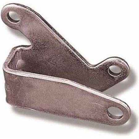

    I believe you'll need a Holley #20-7 throttle lever adapter. It will allow you to keep the Mopar throttle "stud" and mount the kickdown slotted rod. About $12.- at Summit. The throttle pressure linkage must be correct, or the transmission will eventually burn clutches from lack of fluid pressure.
