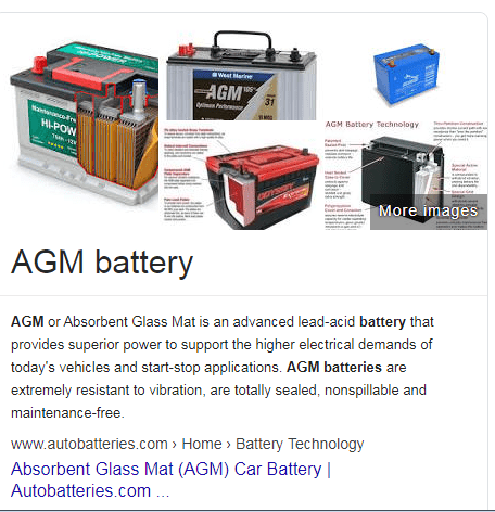

Was trying to be specific but guess I failed. This is the battery.
