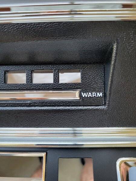

here are a bunch of close ups of lettering and argent.
That looks as good as factory. Thanks
