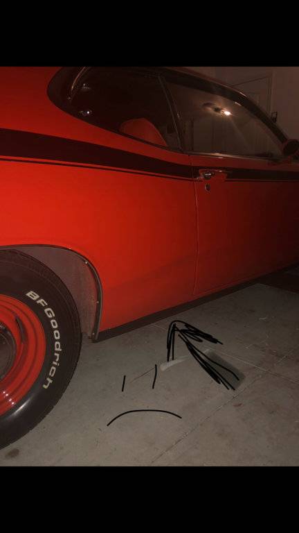

does anyone know where to buy rocker moulding clips for 71 duster the wide moulding all i can find is for the thin moulding thanks, ryan
Sadly it’s been ten years lol and I’m still looking for these clips 9 clips go on each side
It’s the 2 inch WIDE Moulding. Thanks for any help.

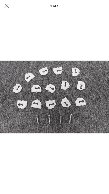

thanks. I used the pic from another thread that is closed now. I don’t have the part # but if anyone has that info. Please send
I see people will sometimes list Cuda Moulding clips as later abody clips also. So if anyone has used these as duster. Clips and it worked let me know

Just for chuckles, I looked up the part number and I think it's 6003437 that you need.
Here's my nos clips and the 2 front clips for the front fender also have aset of chrome trim. Don't know if I'll sale them yet may sale them with the pink 340 car I have
The big clue is the quantity. You said "9" each side, and they show "18" total.
