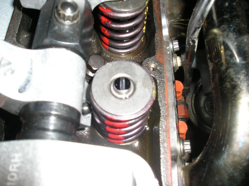

Hughes Big Block, no problems so far, and banana groove shafts with their hold downs. Reasonably priced and geometry was perfect.
Going to go with hughes rockers on my set up .. got some prw's put them back in the box use them for paper weights. geometry is way off on them. not a big fan of them . just my 2 cents.
comp cams rockers, prw rockers, crane gold rockers, prw aluminum rollers, Harland sharp, Hughes...
all will work good with proper set up.
aluminum wont last as long, but i haven't had one fail on me yet.
Now if u dont set any of them up properly and dont check retainer clearance/geometry ....all will fail or cause something else to fail.
