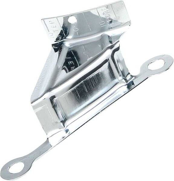

Timing mark on 69 And earlier are not cast into the cover, it is a bolt on steel tab.

65-66 bolt on timing tube or arrow on right . 67 takes a bolt on timing tab with lines on the right. 68-69 molded in on the right. 70 on up molded in on the left.
