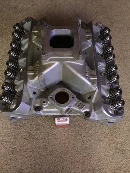

SBC Mopar Single Plane Intake Manifold
Stamped Part # P4452893 (with a small BB stamp on it as well)
I'm having trouble finding exact specs on this manifold with it's unique part number. Another thread thought it was was for W2 heads.
It is direct off my 73' Plymouth Duster 340 small block. Worked great. Decided to switch over to a different set up and a dual plane Eddy.
Price: $170.00 shipped anywhere in the Continental U.S. via FedEx from Spokane, WA
Sold as pictured.
(The BLACK spot in the water hose area is just a water droplet I missed when drying after hand washing it.)
@Wilson340
The intake manifold you have for sale is indeed as you say. That MP single plane intake manifold is for stock heads or the normally seen high performance heads like Edelbrock, Brodix or Trick Flow heads.
I have seen this intake improperly listed as up to 6500/6600 rpm. This manifold is a copied and upgraded Holley Strip Dominator with a 3000 - 7000 rpm operating band.
Further performance can be found by porting and carb pad reworking. This is a very capable intake as is or reworked.
Nice price on the intake.

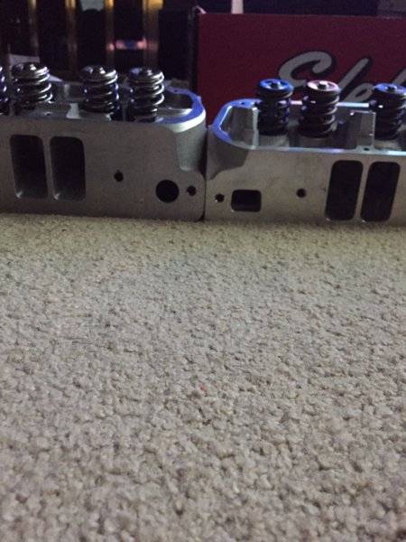

I had in the last posted pictures of the standardintake next to a W5. I marked the off set hole distance with a black sharpie. It is just a little bit off. But a huge amount of you try and bolt it on.
You could use a standard intake bolt pattern on a W5 by re drilling the intake.
It is major, not worth the effort for a W2 Scenario, building a standard intake to a W-2 head. Very hard. It is possible, but it requires a ton of work. In my honest opinion, skip it.
Below is a side by side comparison of the (left) W5 & (the right) Edelbrock head. Notice the bolt hole distance from the port.

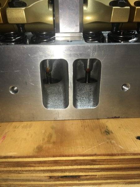

A close up of the W5 head

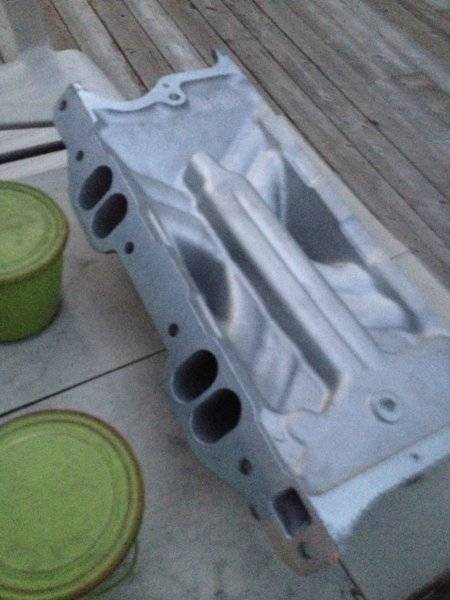

A W2 intake showing very well the oval port
A W5 top end, this is a large port 4150 intake. Notice where the bolt holes are. There far away from the runner which make attaching the intake easier. It also allows room for a maximum effort porting as well as additional help like NO2.
