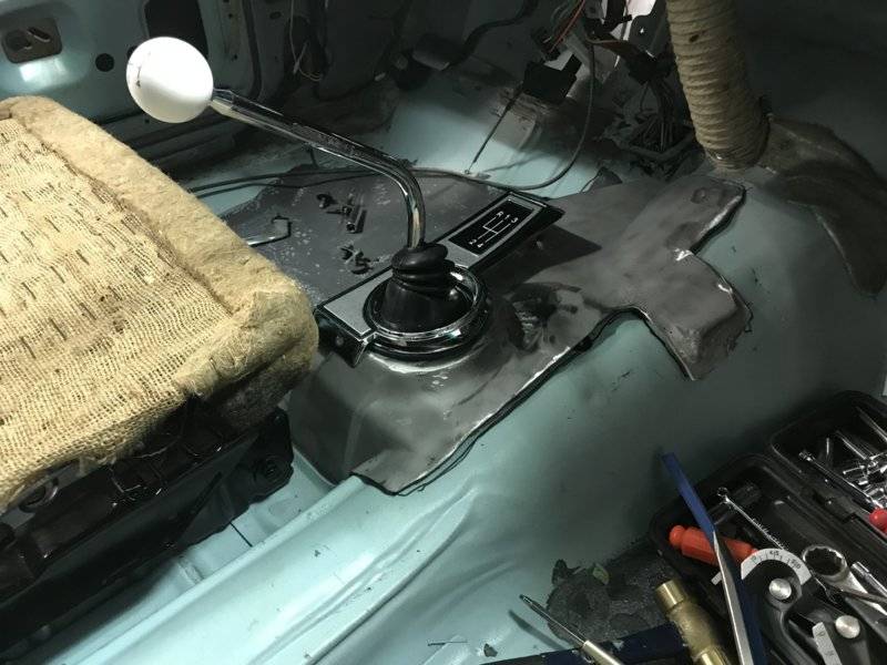

Someone has previously converted my '66 Barracuda to have a A833 4 speed but the transmission hump/tunnel hasn't been done too well.
I want to have a look at some factory tunnels/humps to see how it looks so that I can make mine as close to factory as possible.

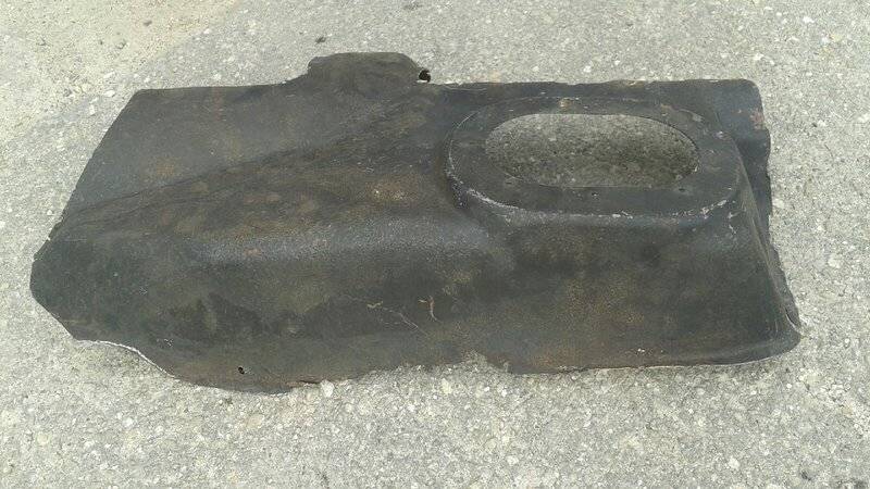

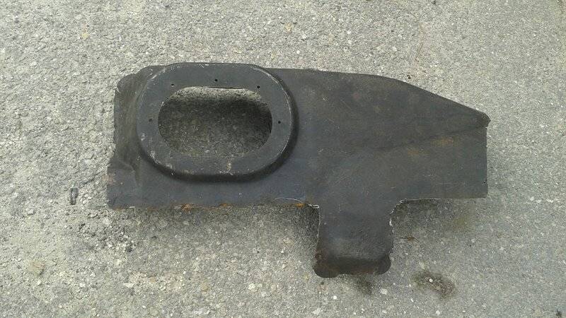

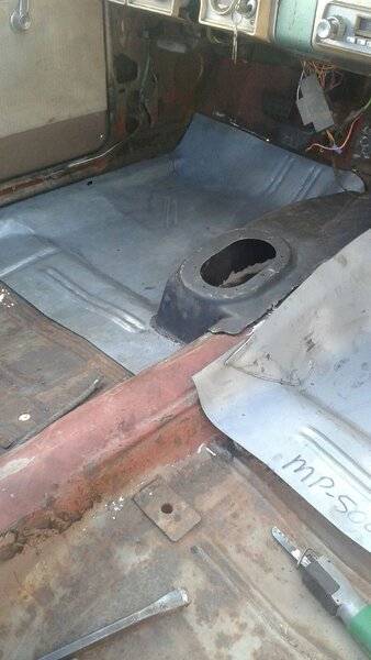

66 floor hump
66 floor hump
Thanks a bunch! So what goes on the 'right' hand side of this when in the car? Are the yellow bits highlighted basically the standard hump? Is the side of the standard hump removed entirely or just a bit to make space for the shifter?

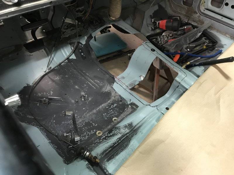

The other photo shows what I have now.

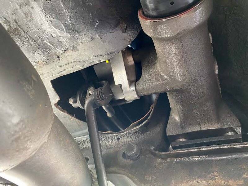

Thanks, do you have a photo from the passenger side? And anything from underneath the car looking at the drivers side? I was wondering if the standard hump e.g. for automatic cars is still partially there or not.
All had the standard automatic hump to start with. Then if it was called for the 4 speed, it looked like the factory took a torch and wacked the driver’s side out for the shift rods clearance. That’s what it looked like on a factory 4 speed in this 65 Barracuda i had a few years ago. The side of the original hump was literally torched out. And when the factory installed the hump it wasn’t much better - a few quick welds here and there and gobs of seam sealer around the perimeter. Must have been a Friday afternoon car!

The four speed hump basically fits right where it’s supposed to on the automatic hump. I’d just cut only enough for rod clearance. That’s what I did on my wagon until I found out i got a bad clutch leg and then really butchered the hump to fit the A500 in there.

Interesting. How does my photo above compare you think?
Mine looked hacked but the upper and lower boots fit as designed. The console covers it all. The guys on the assembly line probably thought "another damn 4 speed! When are they going to get their s**t together and make a hump or a different floor pan." LOL
