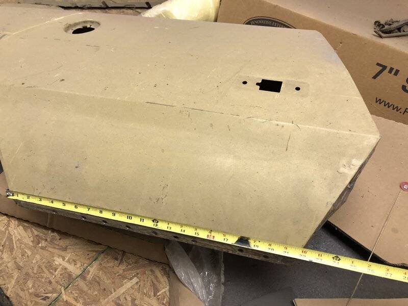

Can anyone confirm if the sheet metal from the front of the wheel opening back, and below the top belt-line, is the same on 70-76 dart hardtops + sedans? I know the overall wheelbase is longer on the sedans. I'm also aware that the sedan rear door "encroaches" on the area that would be rear quarter on the hardtop.
Question is whether section of aftermarket hardtop panel could be used on sedan. Thanks!View attachment 1715844966
I must ask, what damage are you repairing? Do you need a full 1/4?
The quarters are rotted/gone just behind the wheel well up several inches. Combination rust and impact damage. I will need to replace trunk drops. Additionally I have substantial rot and rust on top (12 o'clock position) of the fender well. There are enough dings and dimples throughout that I was planning to replace everything below and left of the dotted lines in my original picture.
Here is a picture of a 2-door and four door panels next to each other ( know bad pic, but only one I had on my phone). The marker light is in a different spot from the rear of the quarter, and the distance from the back of the wheel opening to the rear of the panel appears to be shorter on the four door. I will have to measure this to verify.
