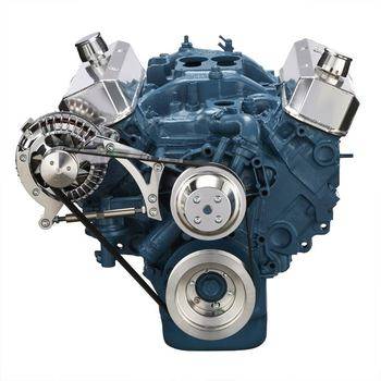

As i look around I am not finding any serpentine kits for a small block dodge. Does anyone have any suggestions? Small block 360.

I'm running the March Dual Serpentine Kit on my 89 318.
Word of caution - let them know what A/C compressor you are using if any. Also, if you are using aluminum heads, other than stock alternator, power steering etc. All of this affects the spacer combinations and belt lengths.
I use the March 10300 kit on the 340 in my Duster, I also have a 3 core aluminum radiator and run a 95-2000 Ford Contour dual electric fan set up. I did have to skip the nose cone on my water pump pulley, but other than that I have plenty of clearance. I didn't install mine for dress up purposes either, I was having a belt throwing issue with the standard V-style belts on my 340 despite having them aligned properly. The 6 rib serpentine belt solved that problem immediately.
