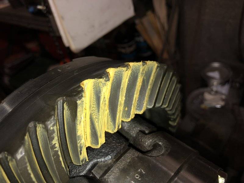

Here is it pattern with a load on the carrier. It doesn’t look like the pattern shown in the instructions that came with the ring and pinion. Thoughts?
According to my math I was dead on at 2.763”
I still think I would run that. In my limited experience you do not always get a pattern identical to those pictures.
But to me you have a similar good pattern on both sides.
Usually the best pattern is not to far off from that pinion depth etched on the gear, imho.
Ok, this I learned from a very old mechanic years ago. U see where the pattern is right on the end of the teeth. It shouldn’t be that close to the end. I would add at least a .010 shim to the pinion to move it back towards the crown. See what u get then. Kim
